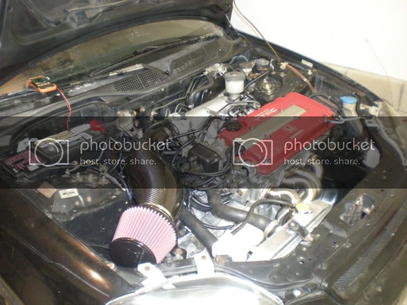

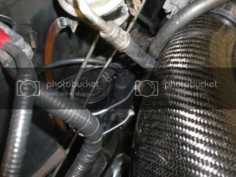

Got it fixed:) I ended up throwing a new stat in and that fixed the problem. I drove it for about 10-15 minutes. It has a slight idle problem. I need to take a video to show you guys. The idle is smooth, but when you rev it, it has a slight hunting idle that takes a while to go away.
I also can't set the ignition timing at 16 degrees. The most retarded I can get it is about 16-17. This SHOULD be in the middle of the range as I rotate the dizzy.

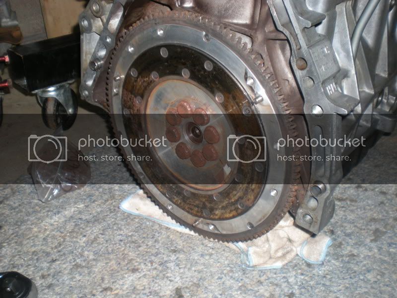

Putting the 8lb fidanza fw sent from Cal. Thanks man:)

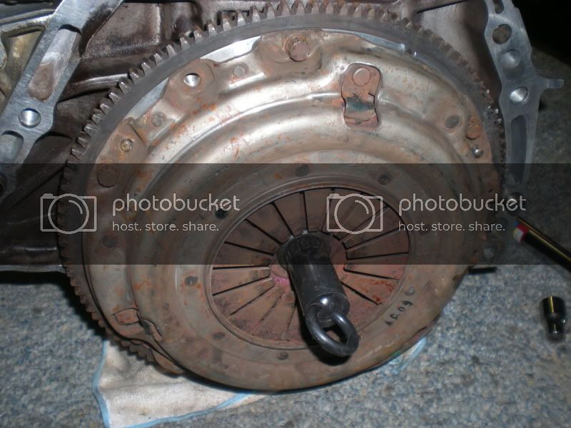

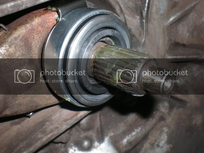

Brand new OEM throwout bearing
And a USED b series clutch. This came on on of my Hmotorsonline engines that I took off and never used. Works great!

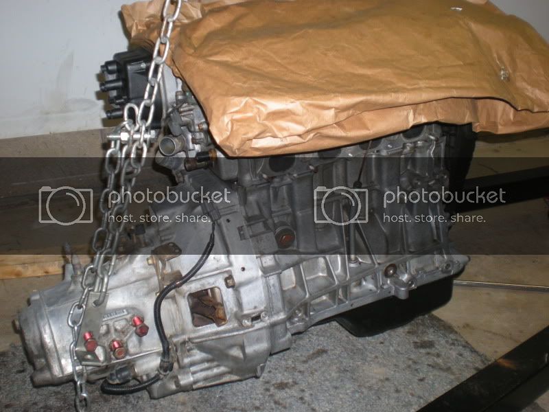

Getting ready to drop the motor into the car. I protected the valve cover with the packaging material the FW came in.

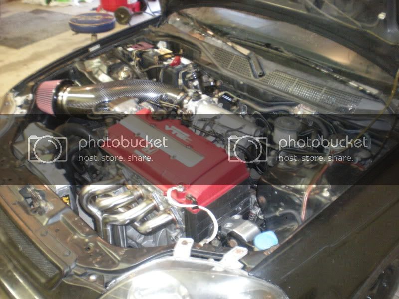

Got it in

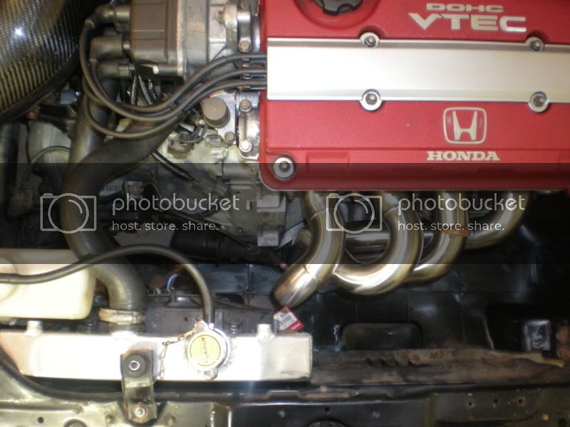

The Mishimoto radiator and fan sent from Turbomirage fit great. This really helped clear the new header.

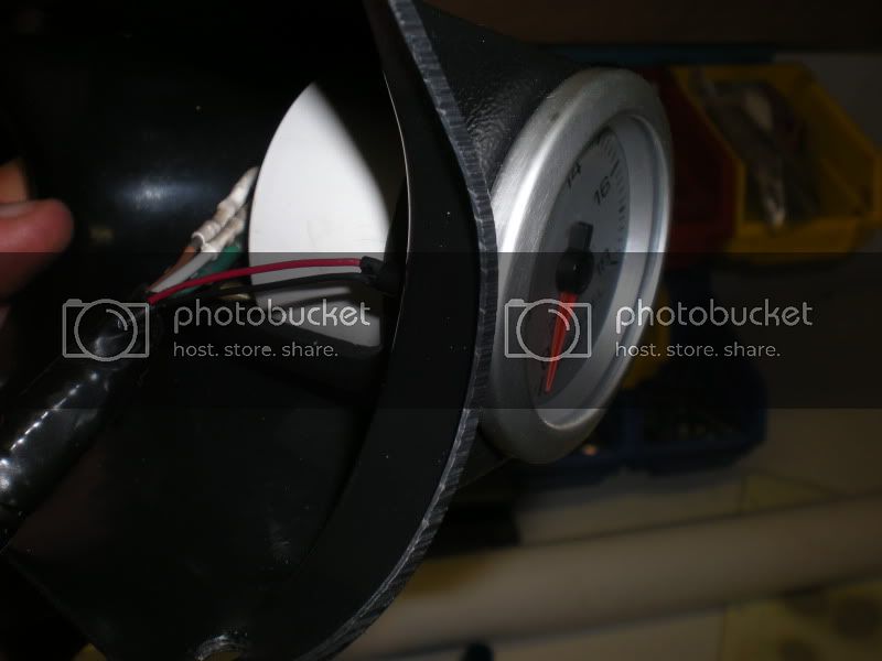

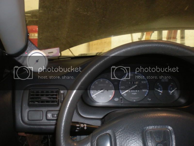

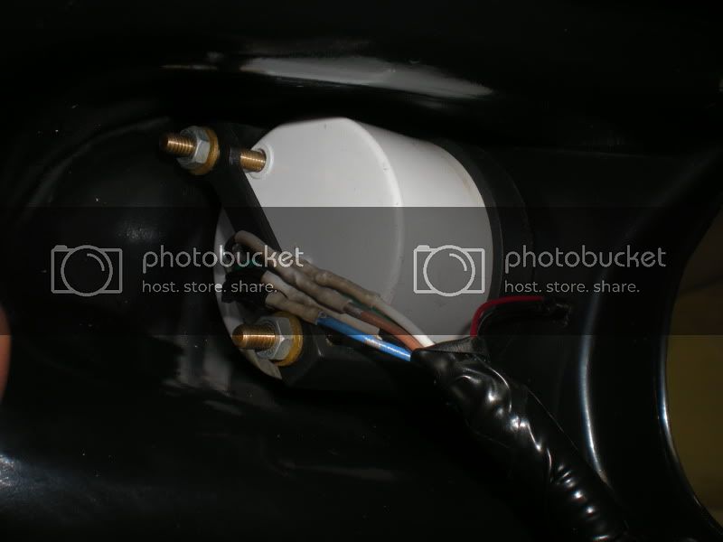

Wiring in the LC-1 and AFR gauge

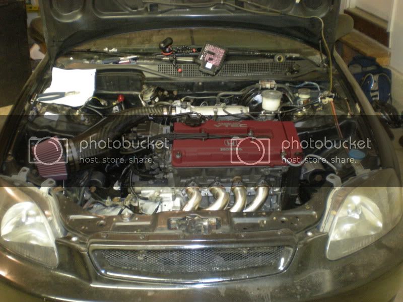

And there it sits outside of the garage. In running shape. First time in a year... I definitely need to score an si grille. I am also not too keen on the black slips anymore. Opinions?
the grill would be nice.. i like the slips on it..
Yer welcome. And super heavy duty packing material courtesy of my last move package. :)
