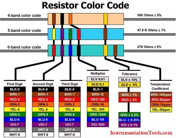

    But since I'm such a nice guy I 'll tell you which set o fresistor you need. It's the one with 2 gold bands on one side and 2 red bands on the other
    *** guide for reading the colors on a resistor http://www.geocities.com/aliciainelp...color-code.gif ***
