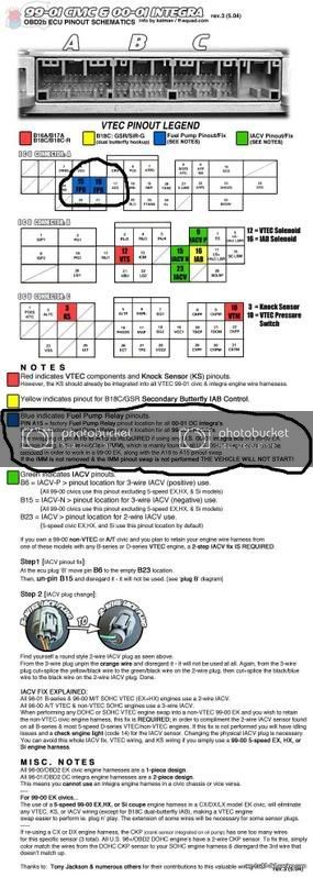

Now you may be getting fuel to the rail but are your injectors pulsing and opening? I am starting to feel an electrical problem or extreme fuel rail/filter cloggage. I mean, these aren't common things at all but we are outside of the realm of the usual suspects and easy fixes and moving towards the type of problem that makes a great story...
good to hear from you again. Yeah i am thinking electrical so i took the motor out once again and cleaned off any ground wire sites and rewired the sensors that were throwing cel. I dont know about the cloggage because wouldnt the engine start on starting fluid? my spring break is ending soon and i still have all the paperwork to fill out for the registration so im dying to solve this story. yeah im gonna take pictures of the vehicle soon so if theres anything that can give you a clue as to what it is just tell me what you want a picture of.
try this
My motors a Obd 1 Jspec B18c. i dotn think this will apply to me but Ill look into it. Thanks.
