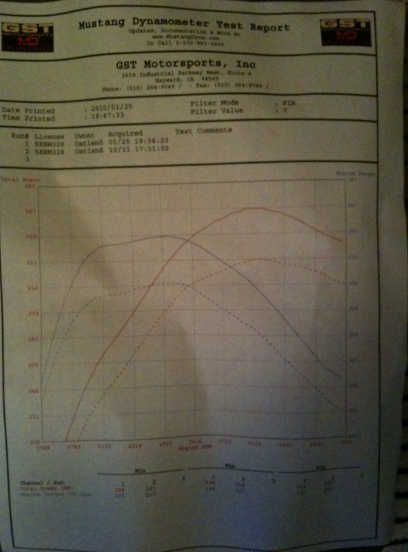

    I recently got some Kelford 272 cams while getting timing belt changed along with some ARP head studs. Tuned on E85 running around 26psi on the stock turbo.
    Mods:
    Kelford 272's
    Generic open air filter
    Tanabe 2.75" down pipe
    3" test pipe
    3" custom Apexi noir cat back
    Rc 1000 cc injectors
    ECU flash tune on E85
    366whp and 349wtq on a Mustang dyno. :)

    how did you run on a stang dyno?? they have them for awd?

    Mustang is a dyno producing company. And yes, they do make AWD dynos.

    Correct, Mustang is a manufacture of Dynometers which create load against the drivetrain. I mention it specifically because Honda's are more used to running on Dynojets which read about 1.15-1.17 times higher.. So DJ HP would be more like 420whp. What a magic number!? :)

    i realise they make AWD dynos swift motorsports has one..i thought he used a RWD dyno for his AWD car..thanx for clearing up the manufacturer lol

    lol @ a RWD dyno. They have either a two-wheel or all-wheel dynos, not FWD, RWD and AWD.:D

    Nice! So you should be over 500 at the crank then right? That's awesome on the stock turbo. Did you do any tuning with gas, or does the car never see gas?
