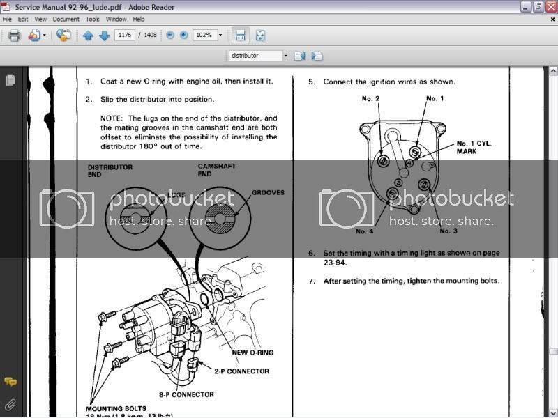

I need to double check my distributor harness plug wire order. i may have miss placed one. so if anyone could get me a good pic of their male end (attached to the dizzy) wires going into the plug so i can see which goes where, it would be very much appreciated.:(
This helps me a little but i need to know which wires go in what place in the harness plug, female end. they came out during removal and i may have installed them wrong.
Are your wires numbered? Look at the diagram at the top right of that page. It lists which wire goes where...
