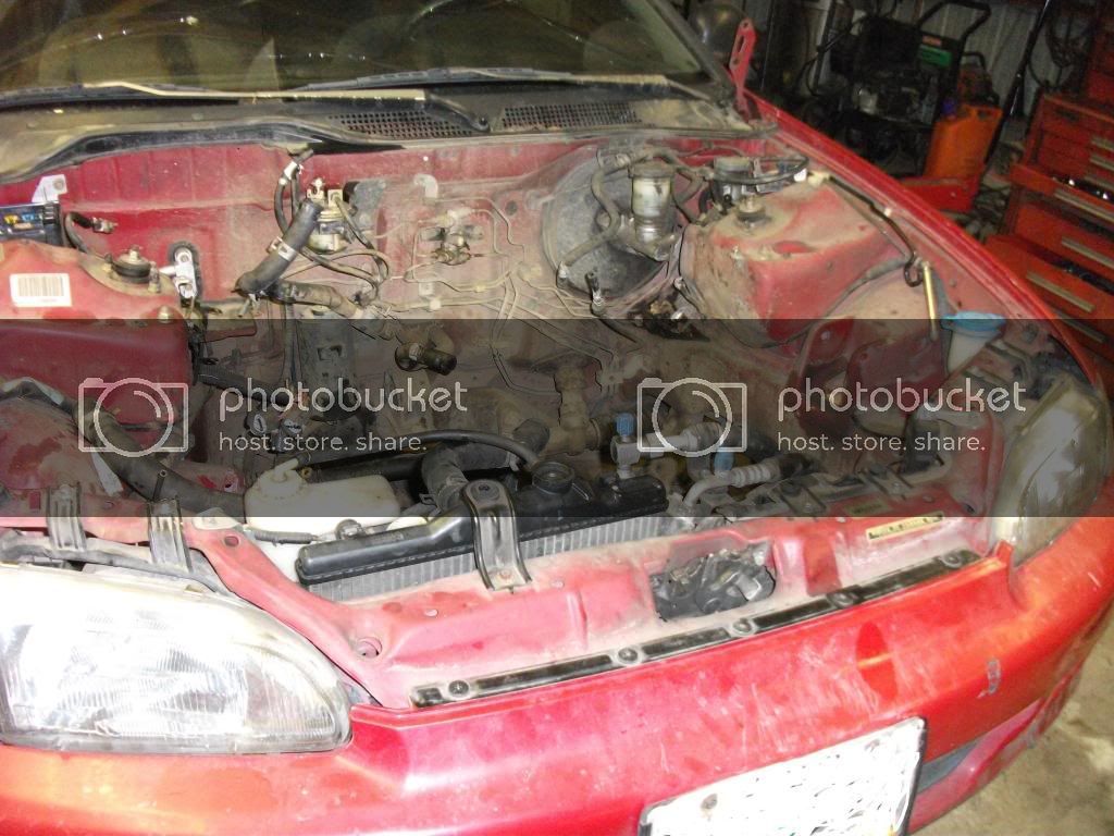

Anyway here is a shot of the motor coming out haha.
Yeah, people have done that before... just make sure nothing gets dropped in through the hole in the cover.

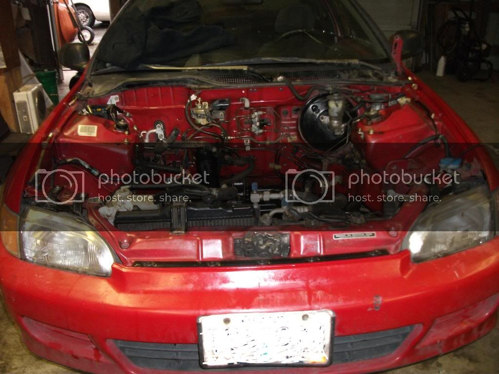

Heres a before of the engine bay.

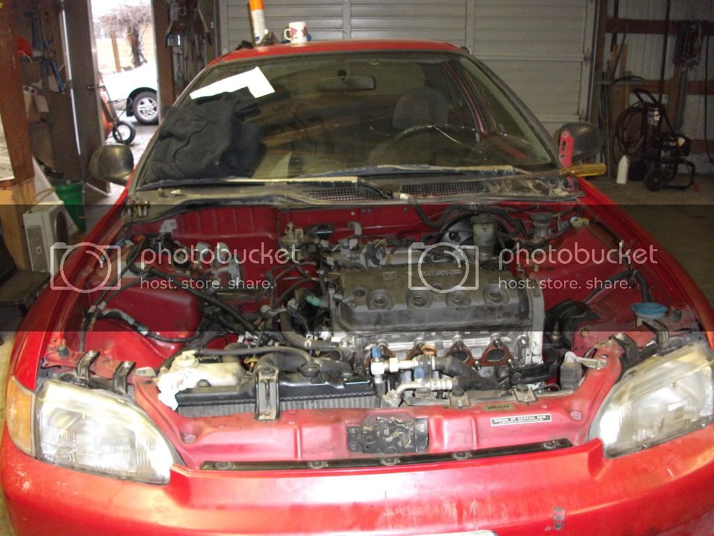

Here is a photo of the D16z6 in.
