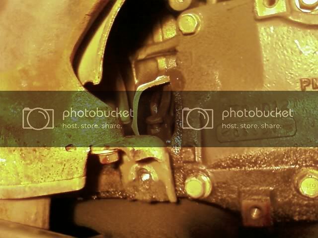

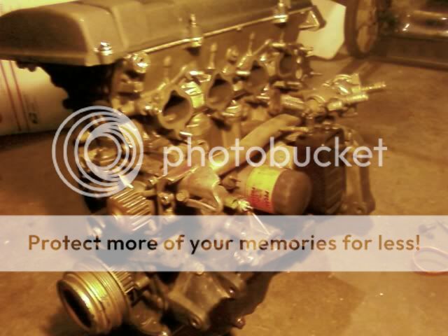

So i start reading up a little bit on swaps, and what pops up on craigslist? a Lot of two 90+93 integra notors with a transmission, an ECU, and linkage for $200. Now as im sure a lot of you know, no true car guy can pass up a deal that good when it could apply to their current project, so of course i bought it.
Pics of what $200 gets you in hillbilly land
http://i404.photobucket.com/albums/pp130/reboticon/Civic/swap1.jpg
http://i404.photobucket.com/albums/pp130/reboticon/Civic/swap2.jpg
http://i404.photobucket.com/albums/pp130/reboticon/Civic/swap3.jpg
http://i404.photobucket.com/albums/pp130/reboticon/Civic/swap4.jpg
http://i404.photobucket.com/albums/pp130/reboticon/Civic/swap5.jpg
I should mention now that my car is auto. After reviewing what I got and whats needed for the swap, ill still need a shifter, clutch, clutch pedal assembly, integra throttle cable, axles, wiring harness, and a mount kit. Is that right? Did I leave anything out or forget anything?

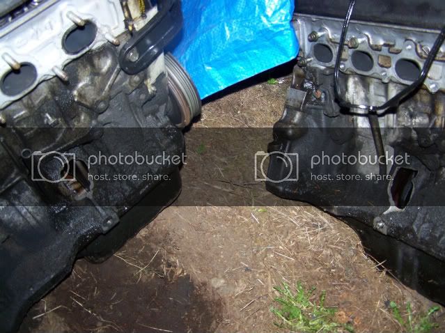

The rain let up so I went and pulled the D15B2. Took about 4 hours which i guess is not to bad for first attempt. I was by myself so it was a trip guiding the motor and working the hoist. Anyone who can do it without hitting the chassis a bunch of times gets my respect. Also some jackass completely managed to wear off the lip on the driver side lower control arm. Took me an hour of mix and matching different puller arms till i found a combination that would break lose the ball joint.
Rebuilding the D15B2 is no longer an option. I gotta admit ive never seen an NA 4 cylinder blow like this. Is it common on Hondas? Im also now assuming that these cars don't have a rev limit on the ECU map?
I've bought 2 (out of 8) Civics of that generation (88-91) and the two that blew up someone attemped to rebuild them and did something wrong. If you take care of these motors ther are good up to 400,000 kms or whaterver the miles converted is. Here is what I have left:
Other then that I think both thoes motors you mensioned are OBD1 so choose more power or less power. The D16Z6 is 125hp and the D15B7 is 102hp. There is basically the same ammount of wiring for both except the D16Z6 has VTEC so you would have to add 3 more wires vs. the D15B7. I would recommend a OBD0 to OBD1 conversion harness which is like $80 shipped of eBay. Other then that everything else should come on the motor (wiring harness, all sensors, manifolds, ect.)
