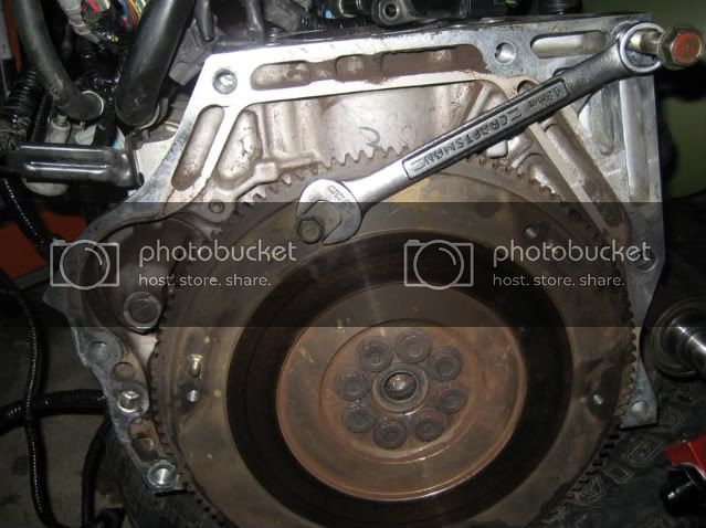

If the tranny is off this is how I take it off.
