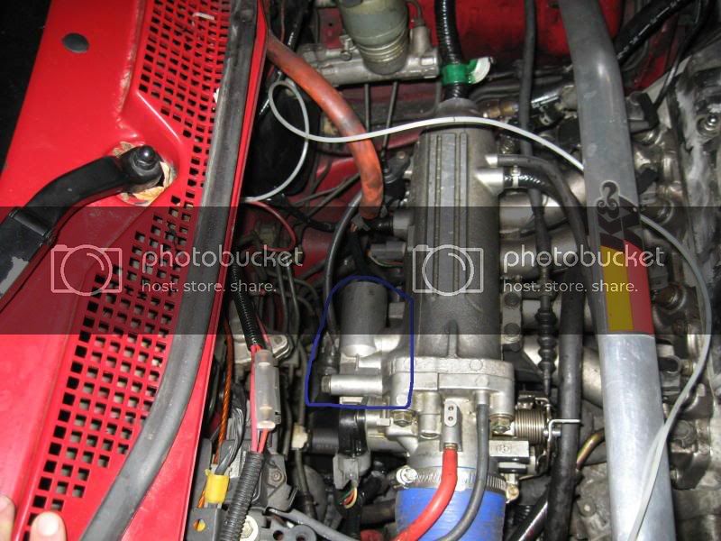

this is the pic of the hose comming off of my pcv valve
and this is were its comming from

That is your iacv (idle air control valve).
There should be a little black box on the back of your block under your intake manifold. Put it in there.

Not that. That should be on your firewall. This box should be under your intake manifold bolted to your engine. It is very hard to see if it is there and you might have to work from under your car to get it in.
oh ok then what about the hose that is on the bottem of the thing that is on my itake mani in the pic about there are2 hoses comming out of them and i cant figure out were they go
