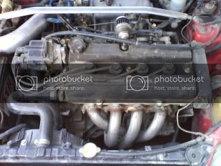

    hi. i have a crx 88 whit motor b18b1 ls. and there have a ecu pr4, the problem is the revolutions only can up to 3handr. revolutions, is for the ECU? or wat is the trouble, whi some one put this ecu,, i buy the car whit the problem ..sorry for my poor english.. photos of my ecu [​IMG] [​IMG] this is the motor [​IMG]

    most of the time if your car is only going to 3 grand, it had a bad distributor. is the ecu flashing any red lights
  3. betorimus
    betorimus New Member
    7
    Nov 11, 2008
    yes is flashing red light. the distributor is not the original is another model because there not have a screw dowm
  4. AHHVTEC
    AHHVTEC Well-Known Member VIP
    13,136
    254
    Oct 13, 2006
    Alabama
    well you need to count the lights that are flashing and tell me how many and if it pauses in between flashes
  5. betorimus
    7
    Nov 11, 2008
    ok. firts 3 flashes pause, 4 flashes pause, 7 flashes pause 1 large pause 1 large and then repit
