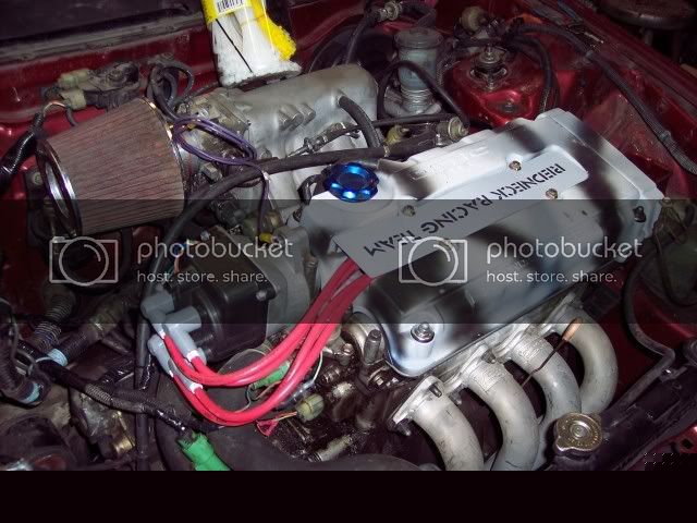

    Hi all. I'm new here. I built a 1988 honda crx dirt track race car. The car has a DOHC ZC, L3 cable tranny, short ram, header, lightend flywheel, and 14" wheels. I have not raced this car yet but practice is next weekend. My question is the motor seems to run very rich and rpm needs to be about 2300 before I give it full throtle or it back fires. I am running a pm6 ecu. I also have a pm7 witch is what is supposed to run the ZC but the pm6 seems to work better. I do not have the o2 sensor hooked up and also no cat. Dose this sound normal? Also any tips to gain power would be great. The track is 3/8 mile so 2nd gear at red line pretty much the whole time.

    Can we see some pics of the car?

    To start with, if you don't hook up the O2 sensor your ECU goes into limp mode- meaning it dumps fuel like crazy and pulls timing to make sure you don't grenade your engine because it thinks that it can't read the air/fuel mixture. Get that O2 sensor hooked back up first.
    The catalytic converter shouldn't be an issue on the non-OBD ECU.

    As Calesta said - your car is a dog because you got rid of the O2 sensor. Hook that thing back up.

    like the others have said... without your o2 hooked up, your ecu and doesnt know how much fuel to put into the motor.. so its dumping it in there

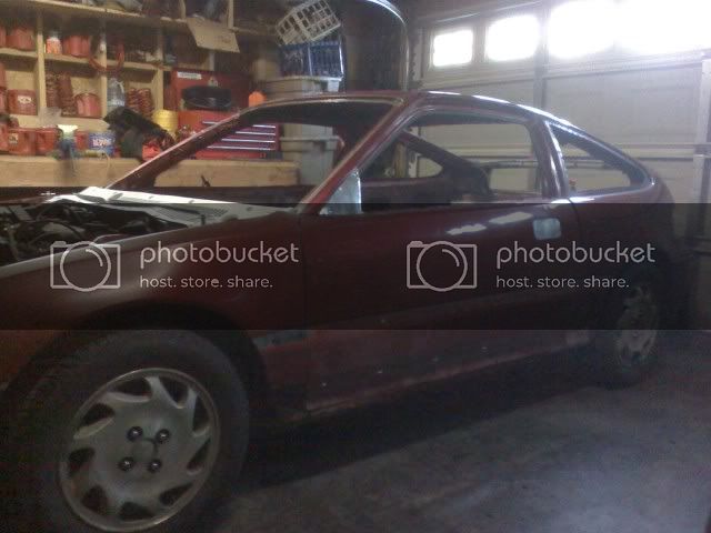

    not trying to thread jack but heres a pic of mine
    everyone likes pics;)

    first listen to them about your o2 sensor problem
