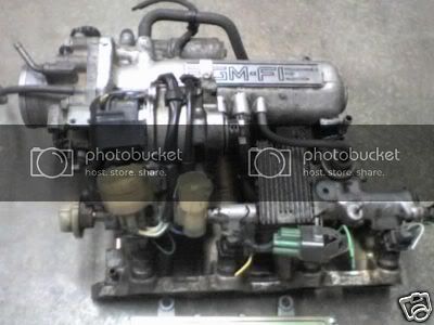

    :rawr: just bought a crx dc its in nice shape with i am sure all original parts included havent found much jimmyrigged yet, so anyways i want to put the mpfi from an si on it how much do i need?
    [​IMG]the so called conversion or

    to do the DPFI to MPFI swap, you need the intake manifold with sensors - Electronic Air Control Valve (EACV) and Intake Air Temp, new intake manifold gasket, throttle body (with TPS), fuel rail, fuel pressure regulator, fuel injectors, injector resistor box with wiring connectors, distributor, fuel line from filter to fuel rail, ECU and injector wiring with connectors
    the intake manifold in your second picture appears to be from a DOHC ZC which won't work on the SOHC engine

    so should i even do the swap? i dont even know where to start looking for those kind of parts.the eacv air temp and what else can i salvage from the si?

    sure, do the swap - the top picture looks like it has everything you would need, except i don't see the fuel line from the filter to the fuel rail

    mk that was just a ebay pic looks like theres way to much stuff on it

    looks right to me - has intake manifold with the sensors and throttle body, distributor, fuel rail, fuel pressure regulator and injectors, injector resistor box with wiring connector, injector wiring connectors and ECU - just lacking fuel line and you would need a new gasket
