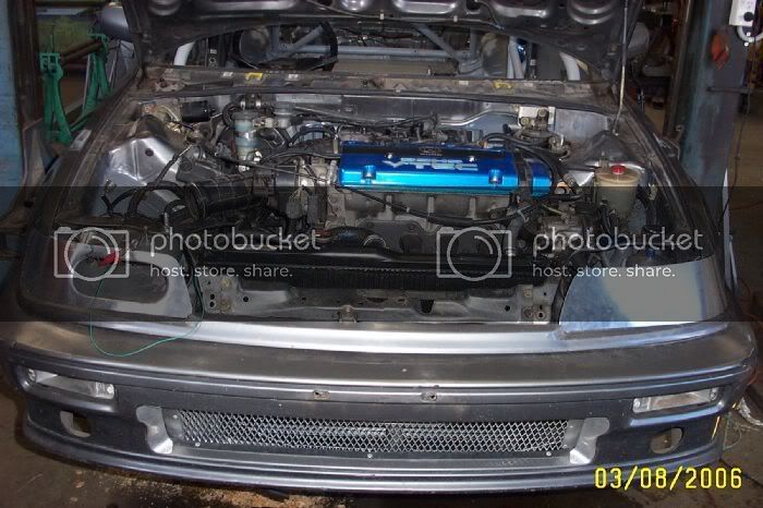

    If your interested:
    It will be a major headache. This is a race car that my father and I are doing. There's not a hell of alot of space in the engine bay. It's possible to get it in without cutting the firewall, but you'll need to tilt the engine. We didn't want to tilt the engine so we cut the firewall and put a hatch into it. I have a full build thread of this car on another site if your interested still.

    First time post. Been reading for several weeks. I am in the middle of almost the same swap you are asking about.
    I have an H23A1 in an 85 CRX. Yes it will fit but it is really tight. You cannot even think about having A/C and the alternator is really close to the stock crx front mount ears. Firewall must be adjusted ( large sledge hammer). All the engine mounts are pieced together from several other hondas and some parts are hand made.
    As far as money goes, I found the car for $200, the h23 for $100 ( with blown headgasket and one bent rod). Tranny was $60 from Pull-a-Part, along with most of the other parts including a complete wiring harness from a 91 accord. Total so far less than $600.
    This is a RACE ONLY vehicle. Everything that was inside and all the trim, lights and glass are gone. The car has a full roll cage because, and was built just for " Buzz Car" racing. Part of the rules is a $500 claim for anyone car, so it has to be cheap and could be totaled out at any time ( wrecks happen in racing).
