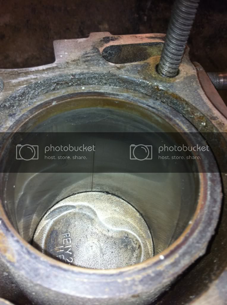

There is a scratch in one of the cylinders. Will I need to have them bored?
If it's a shallow scratch, possibly honing would be enough to smoothen it out. Remember, reboring means oversized pistons and rings.
