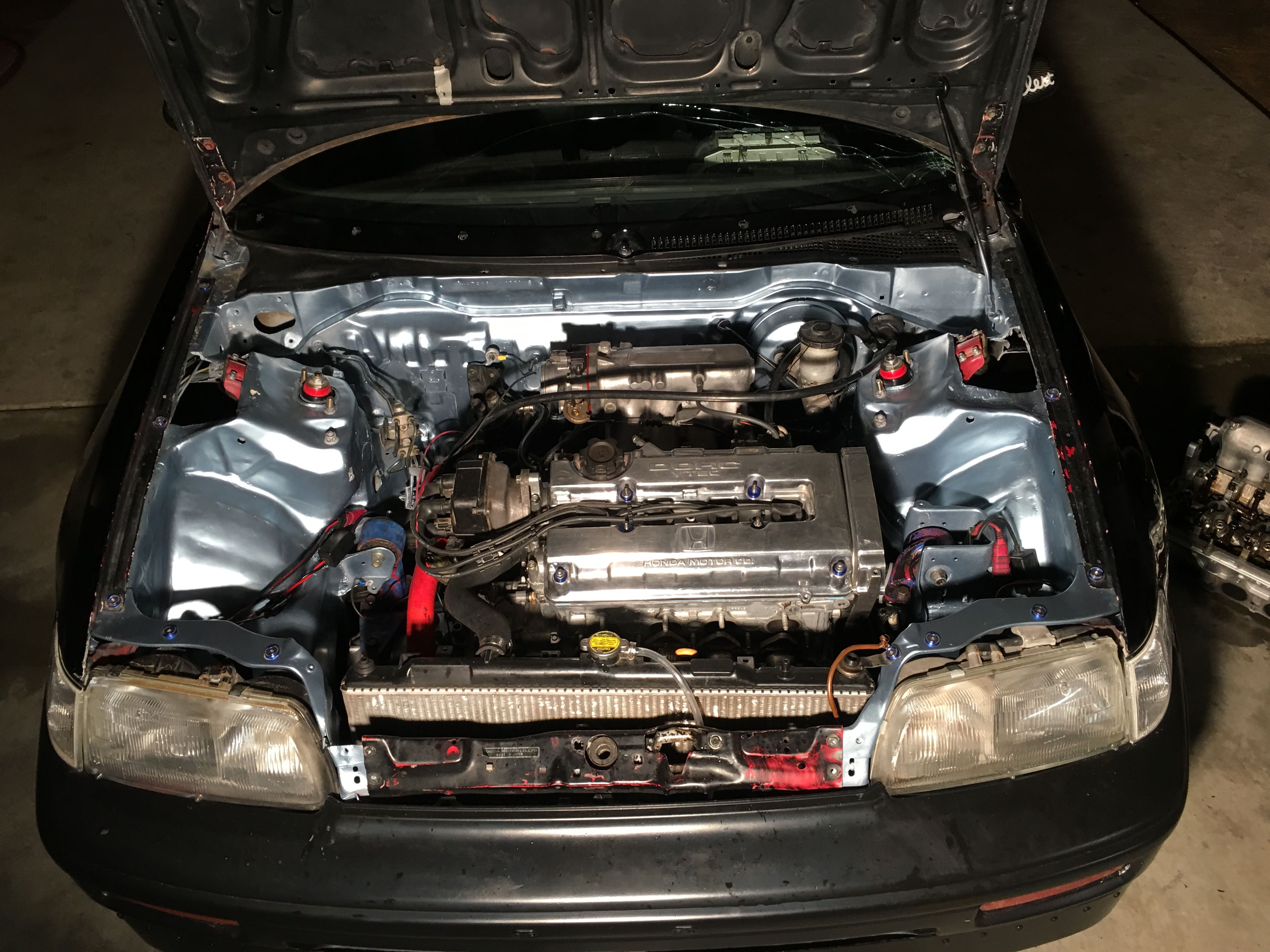

    What's up guys so I have a 1989 crx si with a lsv b18b1 block and a b16 head converted over to obd1, yes I deleted the little ground box for the injectors and put them altogether with the red wire the car ran perfect I started to cut my ac plugs off my dash harness and put a new chip in my ecu for lsv tuned I'm running a pr4 chipped whit h worded with the old chip ever since I cut my ac plugs off the car only idles when giving gas it dies out so I put a 1990 crx si dash harness in the car everything connected right up go to try and sart the car nothing....fuel pump turns on I get spark (sometimes) still haven't found out why I only get spark sometime days when I work on the car then I look at the plugs the cylinders are flooded so I take the fuel rail off have my dad turn the keep on and crank it over the injectors are spraying like crazy like fuel blast the motor culled up with gas oil was so deluded so put be oil new injectors and regulator sill having the same problem if anyone could help me please Iv been bashing my head in for the past week looking over everything thanks
