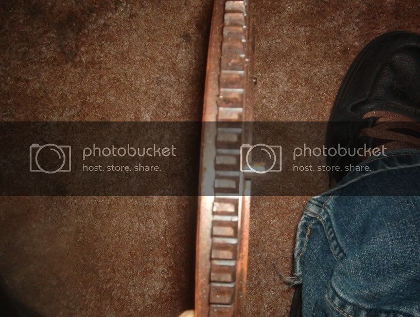

and in the pics he...showed me the CTR fly vs. a B16A and it looks alot thinner so .....it looks lighter
does this look about right?? the package said it weighed 17 lbs...
that sounds about right... I bought a ITR flywheel for $80 shipped. The package said it weighed like 17.2 lbs... I got it resurfaced and with a brand new exedy clutch, I haven't had a problem to date. i've put about 30k miles on it and the whole set up is still going strong.

I never had the stock B16 flywheel on my car, I just went straight with the ITR one. but i've noticed that i do have slightly quicker revs and throttle response than some of my friends who are on their stock b16 flywheels.
