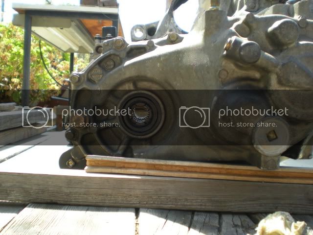

here are a couple of pictures of mine:

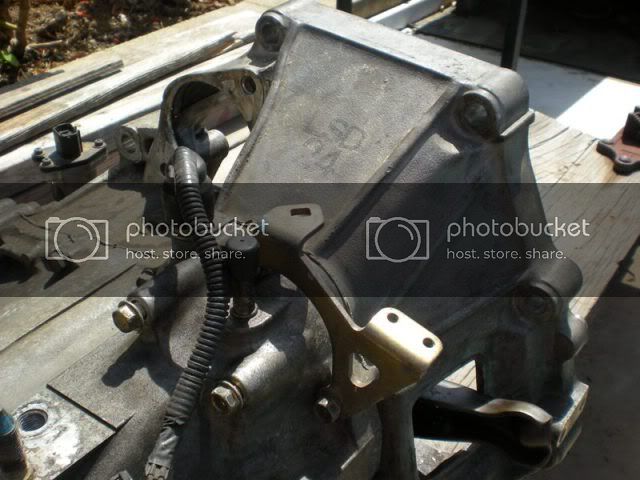

this shows the marking stamped on the case.
it would not be hard to pull the differential out and put it into another 92-00 EX trans.
you should see daylight when you look though the holes for the axles
