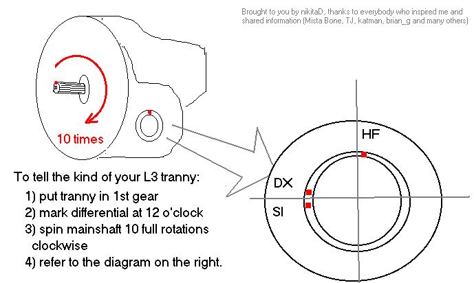

All transmissions say the same thing; PL3 or L3. Easiest way is to see the car it came out of. Then, there's differential diameter(Si is 40mm, DX is 35mm).
And then, there's this method:
This is the thread I got the pics out of(there's good info in there also): what to look for to identify si tranny? - Page 2 - Honda-Tech
Also, be sure to check the input shaft. 89-91 is recommended as 88 has a different spline count.
