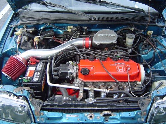

exactly..check the code on the engine..and take pix of the bay...is there a resistor box on the drivers shock tower?
does your engine bay look like this
