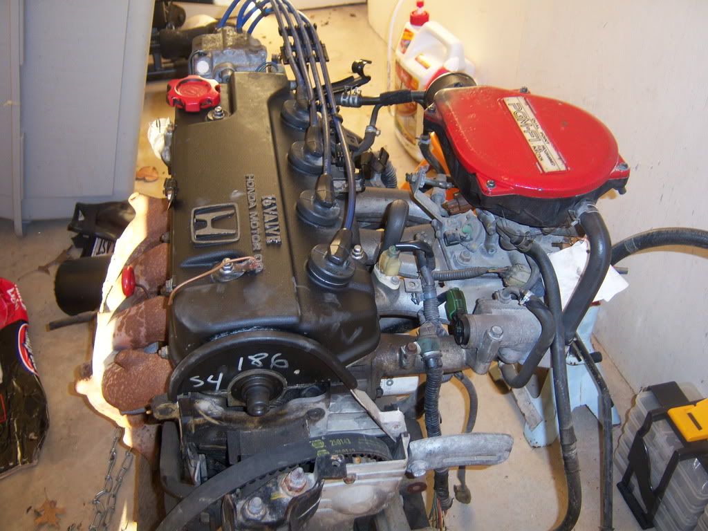

    do I need to do anything specil during the swap?I want the much smaller d15b6 out and the d15b2 in ASAP HELP ME pls[​IMG]

    Ok. well our doing the opposite than what most people do. the engines are roughly the same displacement. just one has less power. Try to source a PM6 ecu and an intake manifold for MPFI, its a lot easier than trying to get it to DPFI.
    Looks like the cam gear on the other engine is off along with the belt. Double check there isnt anything wrong with the other engine. get the belt on as well as timing, and at least compression check the thing before it goes into the car.

    thanks for the advice I have been all over the place looking for the answer so for the help of anyone else who finds themselves in this....most people think its a waste of time....you have to go from dpfi to mpfi mpfi is ALOT better ......you only have to change the ecu and gangster wire the other fuel injectors to put it basically.... also ( this is the point ) you should go for a d16 or a b-series if your considering a swap---- thats most peoples opinion.Atleast SOMEONE said something

    I did compresion tests and leakdowns also checked fuel air fire......Im a technician anyone worth thier salt knows that and d15b6 is DPFI d15b2 is MPFI Im putting in a d16 or b16 instead after feilding alot of drama for this

    Keep the HF distributor and manifold and SKIP the DPFI conversion.
    Later on, if you want to work the D a little; Si camshaft/Y8 cam gear, Si ECU, PM7 pistons, Si manifold; and you'll see a noticeable gain.
    There are guys with D-series putting down more power than the B16 for less the price of the swap. But, if you're looking for more power later on then B-series will be a better route.

    Looks like you ought to use the old dist and intake on your DPFI engine. They should change out, and then no wiring changes.

    Just transmfer the HF intake manifold, engine harness, and distributor.

    But if you want it like that, to each his own:
    * Swap all of the MPFI components from the B6 to the B2
    And just a little thought:
    * Swap over the B6 manifold and junkyard turbo the B2
