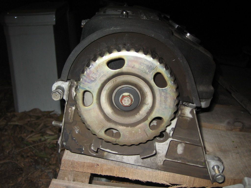

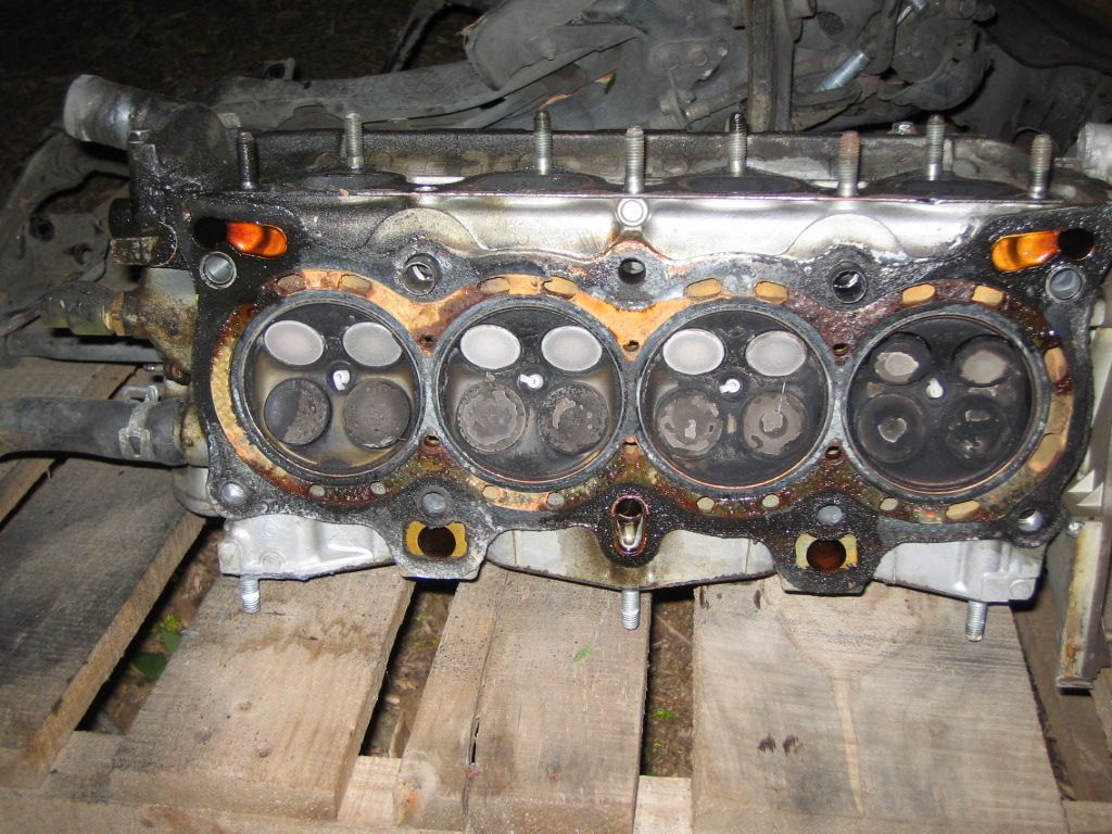

    So I made it back to the Pick-a-part today. Super excited... Pulled the head, got the complete head, along with the valve cover, cam gear, and timing belt cover. I also had enough time to get under the car and I managed to pull the entire rear trailing arm / disk brake assemblies, along with the factory rear sway bar!!!.... But that will be a discussion for another day, and another forum ( but I still might sneak a few pics of them, just cause I'm proud that I landed them :) )
    I work in the morning Saturday, but I'll try and get pics taken and up once I get home tomorrow.
    Thanks again for all of the input and ideas / suggestions. This is still a learning curve for me, but I'm having fun with it!

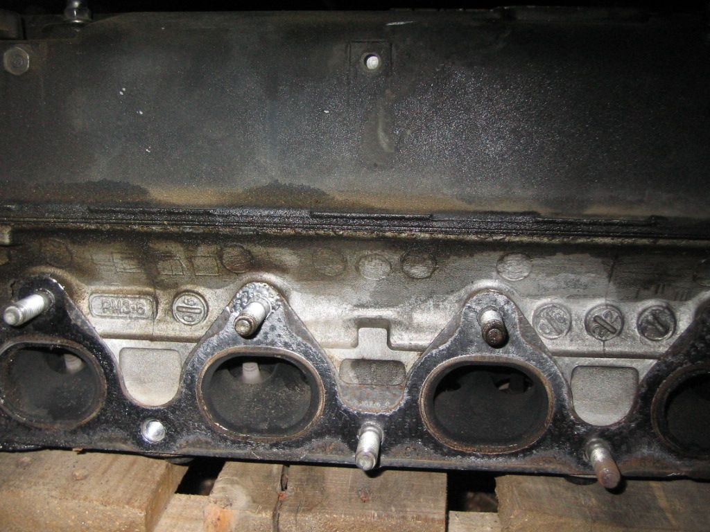

    So here are the parts I picked up on my days off this week. Can anyone help me ID this head??? I have looked at several head Identification lists on several forums but I have yet to see this actual designation "PM3-6"
    Looks yummy!!! not.... Hopefully I can get the head out to the local shop sometime next week. While they have it apart, I'll get them to give me the #'s on the cam so I can ID it. More pics in the next post....:D

    i think its just a basic non-vtec zc. i cant recall if the actual a6 head said pm3-6 or if it said pm-6..
    What are you going to have the shop do to it?

    my A6 (off a 91 Si) is printed PM9-5... my Y8 (got off ebay... believe its off a 98 automatic Ex) is stamped P2J-4
