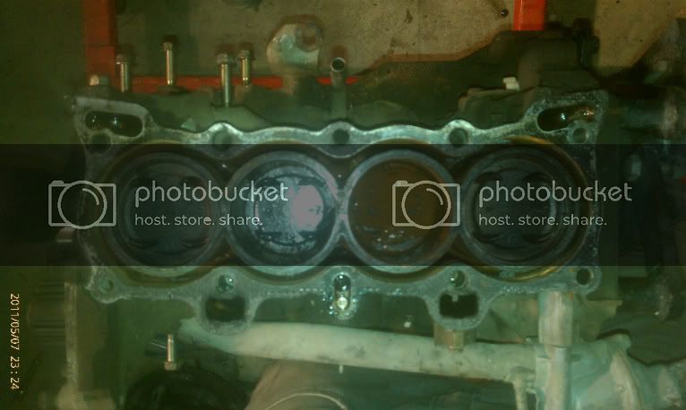

    Needed some love haha...
    hmm water an chucks of steel...thats not good ehh.
    Think the gasket was leaking?the cylinder walls dont have any major defects except for the fact that they are smooth as a baby's a$$...
    ill prob end up taking the block/head to a shop near here to have them run some measurements for me.
    if its not salvageable without a sleeve im either buying another one or building a turbo application lol.
    time to start crunching some numbers.

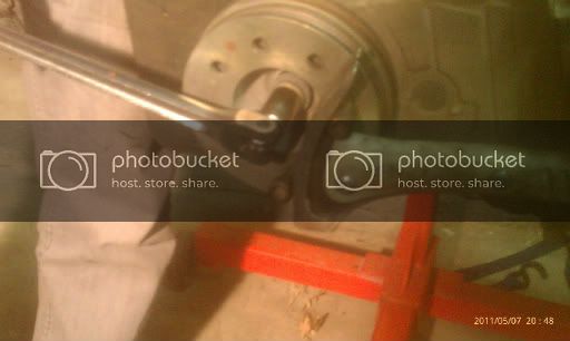

    That supposed to be bent?lol
