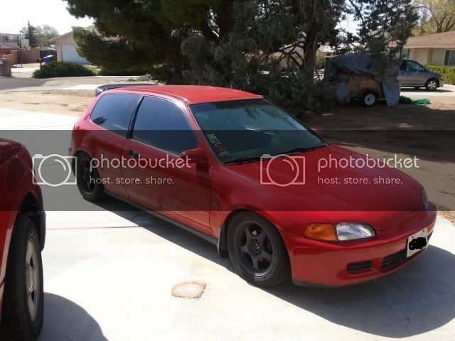

Buying a 94 eg,pistons or piston rigs are shot.Car is ridiculously clean,Turbo set up was done well except for a couple zip ties.tien's all the way around blahblahblah.long story short a shit ton of money was put into this car.
I would like to bring it back to life.its to clean to just let rot away and my girlfriend only wants 2K for it.
I want to stick with the D-series and shoot for 250-300HP,I would like to build the block/head with a set up capable of 400HP and up,this way when more money comes in, i have room to play with it.Im also going to be using this as a DD.This is my reasoning behind wanting to build a block capable of more then im going to put it through.(Mainly longevity).
So Witch block should i use?d15 or d16.I have two d16's laying around.And whats currently in the car is a D15b.I also have two h22a laying around, but more then likely will sell them to help fund this project or to at least put some cash back in my pockets.
