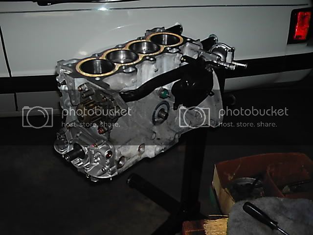

here is my z6 when i was putting it together:
alright thanks, what is that black box for exactly also? i took a picture of mine but my sd slot on my computer isnt working so i cant really upload any pics right now
its for the Positive Crankcase Ventilation (PCV).
for relieving positive pressure in the crankcase.
it allows the vapors to escape but the oil goes back into the block.
the pcv valve in the intake manifold is connected to it by a hose.
