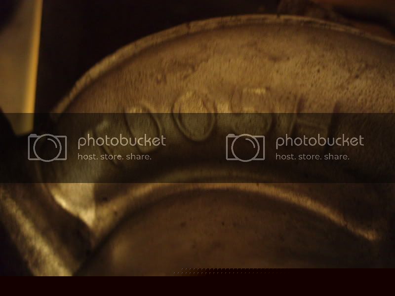

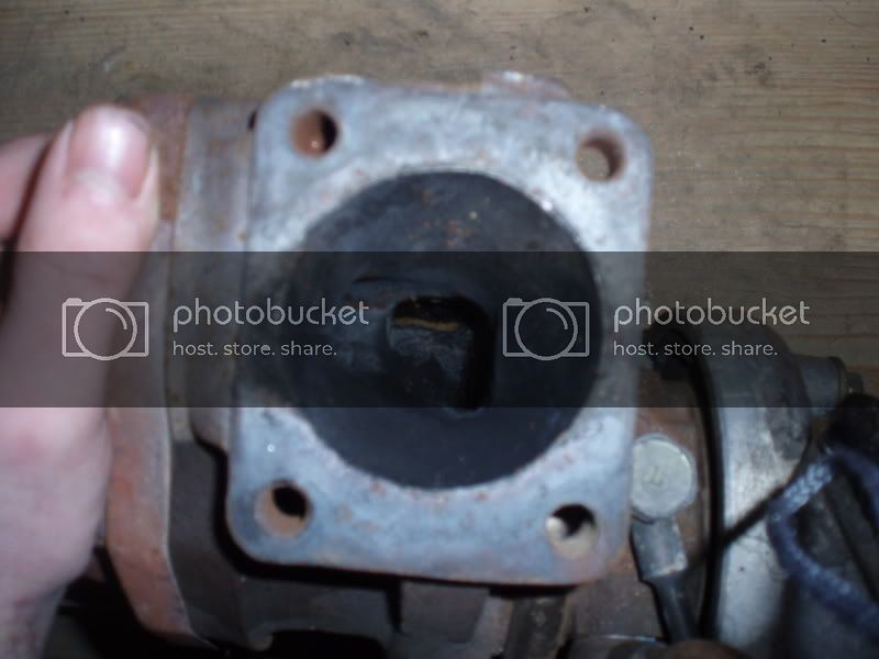

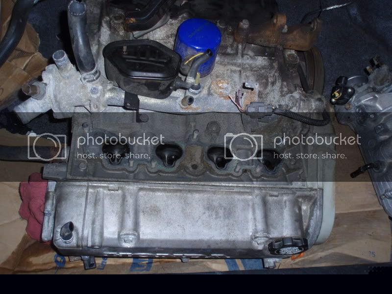

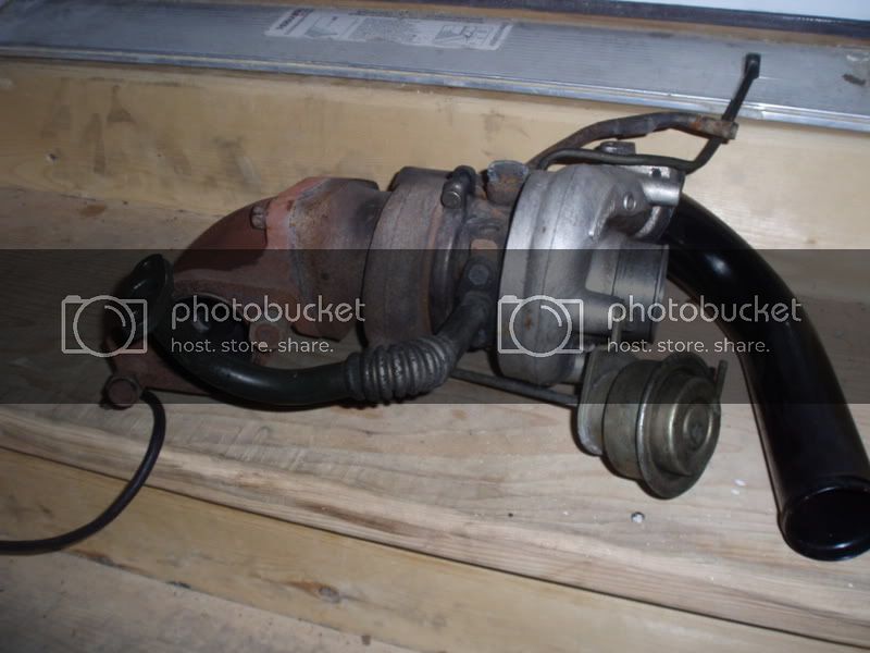

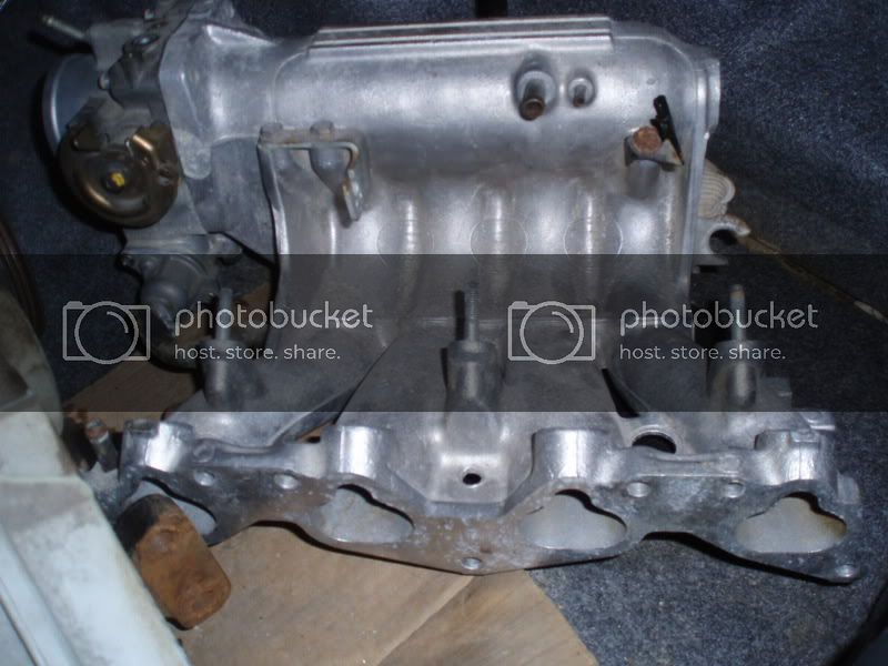

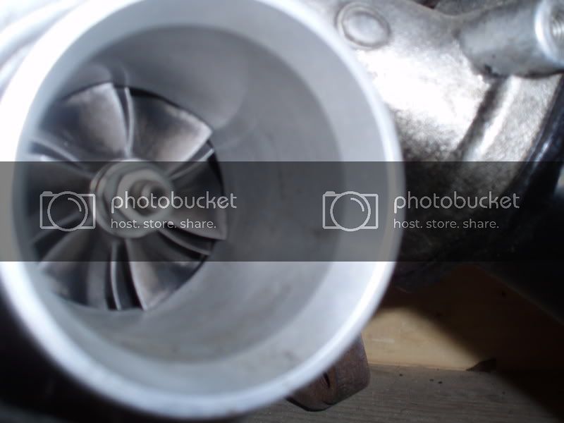

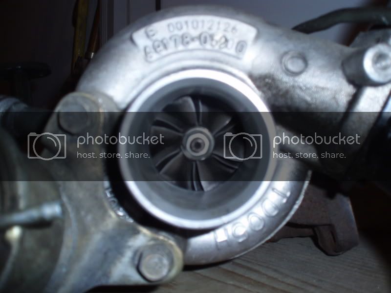

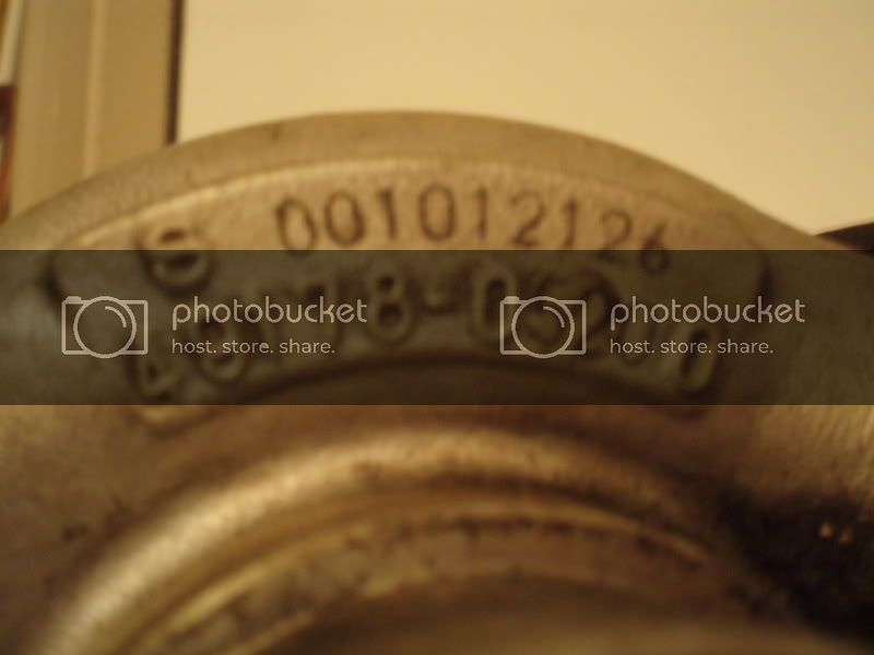

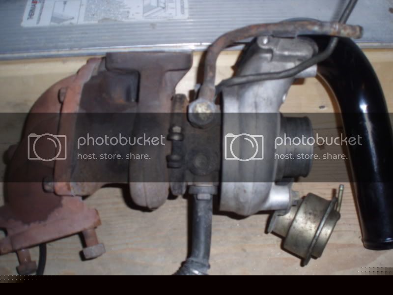

    Heres the pics of the Y7 motor I picked up and the TD05H small 16g turbo I got for cheap :D

    just dropped the motor at my buddies tonihgt, the tear down will start this weekend... and I also have the pistons coming in... FMIC, BOV, T25, which is up for sale now... and mani. so I will be posting up those pics soon...
