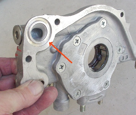

The ebay ones are similar to stock. The modification is simply porting the oil ports for a smooth flow and shimming the oil pressure relief valve(to increase max pressure).
Here's Endyn's ported pump:
