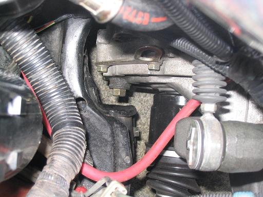

ha, the clearence issue is what he was talking about? haha this is the only clearence issue right here: this is straight from the motor mount website:
The picture above shows where we had to heat up with a torch and slightly dent the rear crossmember in order to gain clearance for the transmission filler plug. As you can see we clearanced it a lot more than necessary. When we first mocked up and experimented with different engine locations, we at one time had the engine set back farther and at a different angle. But after many hours of adjusting the mock up kit, this was the best setup. So you will not have to clearance near as much as we have done. The best way to determine what clearance is needed is to bolt up the driver side mount and then level and angle the motor to the specs that we provide in the kit. This will show you how much and where you need clearance and also where you must locate the passenger side chassis mount.

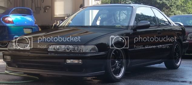

Before:
After:
What I did today:
removed mud-flaps
removed altezza's
removed trunk hydraulics
installed OEM tails
installed trunk hydraulics
installed OEM front lip
5 minute wash
rotated tires
Tomorrow's plan: replace my broken rear-view mirror with a really nice one from a Mercury Sable then bitch at the motor mount guy for a couple hours b/c they haven't come yet...grrr
What do you guys think? i like it a lot...
