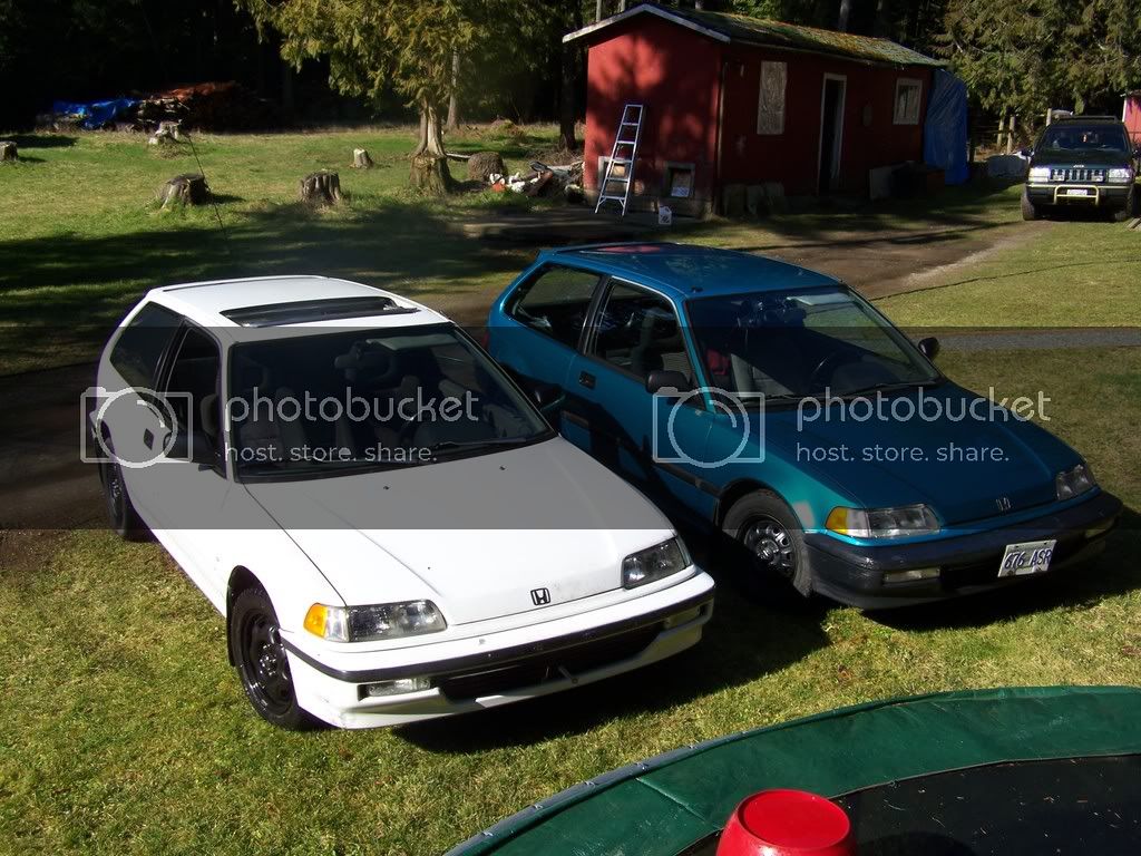

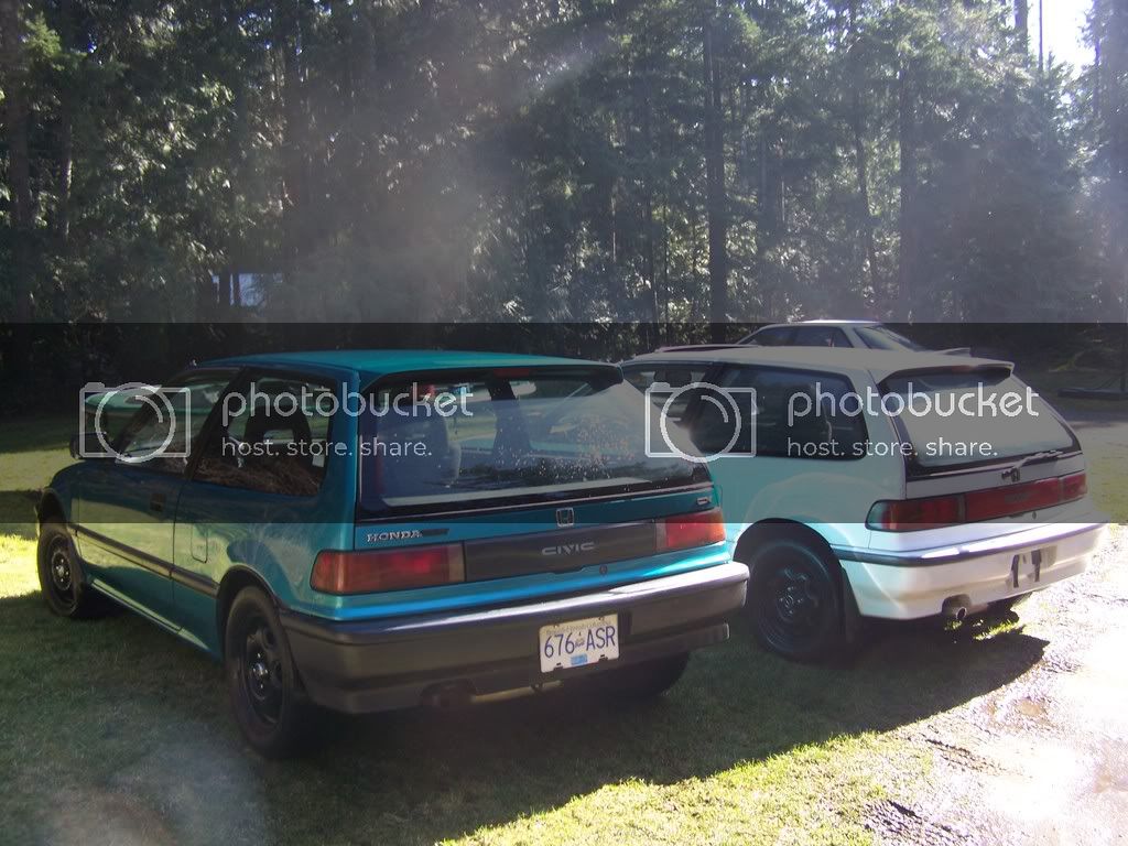

    Sorry for the threadjack Matt but I have to show these old pictures.
    When my dad had the car (my car is white) :
