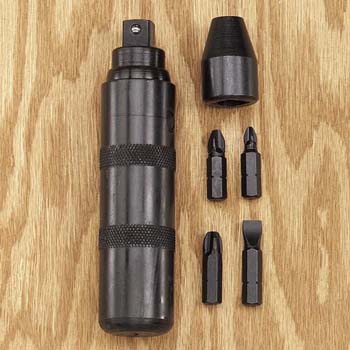

    Replacing rotors, calipers and pads on my 97 Del Sol B16 Vtec. Rotors held on by screws? As soon as I applied pressure the screws buggered up. How do I get them out? While we're at it I'll take suggestions on best after market calipers, rotors, pads. Daily driver and plan to keep for extended period.

    I usually add some heat fromthe torch and they come right out if not I cut them off and grind them flat

    Use the correct tool; an impact driver. It looks like a screwdriver that you hit with a hammer.

    ^^^^^^Thats the best way to do it...

    I usually use the impact driver!!! But in some cases I have had to use the torches to heat the screw up and the. Use the hammer and impact driver.I live in Vermont where there is lots of salt on the roads so I usually have to heat them up

    Thanks for the info. I got an impact driver from a buddy and it worked perfect.
