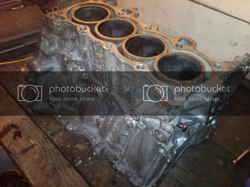

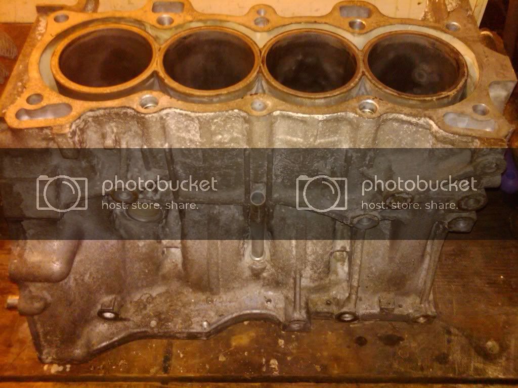

The block was insanely dirty and grimy when it came into my possession. The tear down N' bagging process only took about 20 minutes but from there it was just a matter of getting it somewhat clean before the machine shop gets it. Big thanks to Brandon for helping with a little Cuda action. BTW Wheel Etching for cleaning a block goes a long ways...

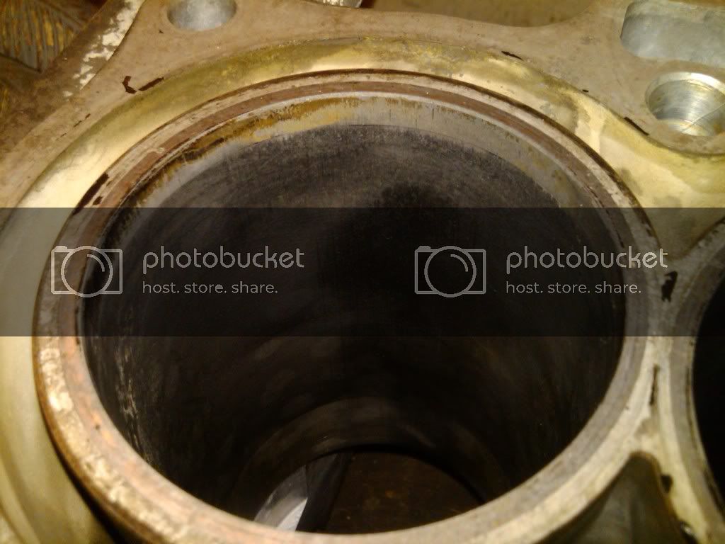

The walls seem to be pretty decent when I got it, but I'm not going to risk anything so I will just take them out to 75.5 mm so I have the peace of mind.
As much chemical and cleaning as we did the block is still kinda 'barnacle like.' I will have to scrub it and see how it looks after the hot tanking by the machine shop. If its not bling'in...Ill have to just paint it.

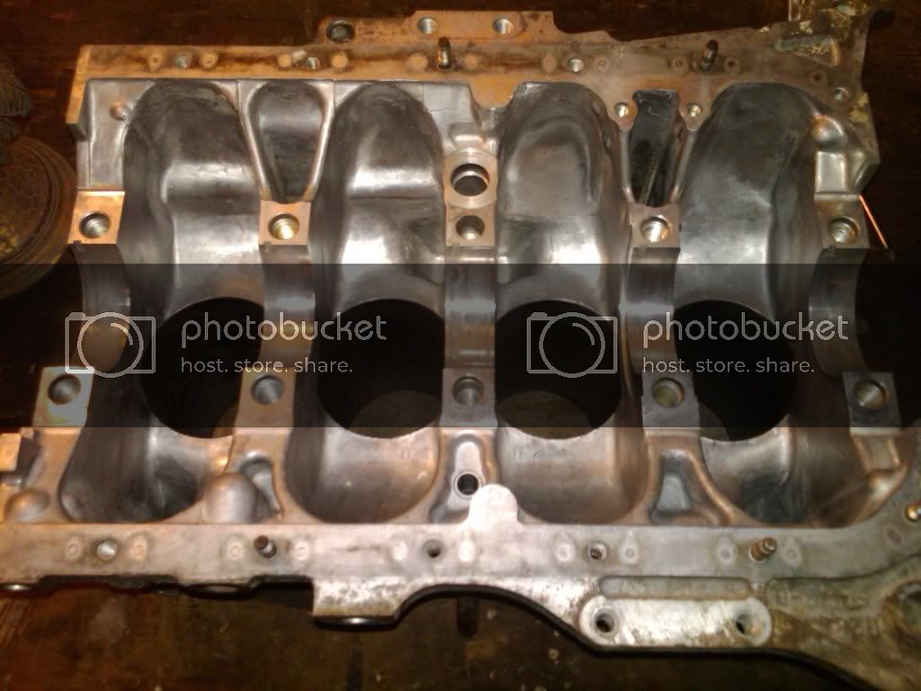

Everything with the internals of the block look perfect. Mmm clean.

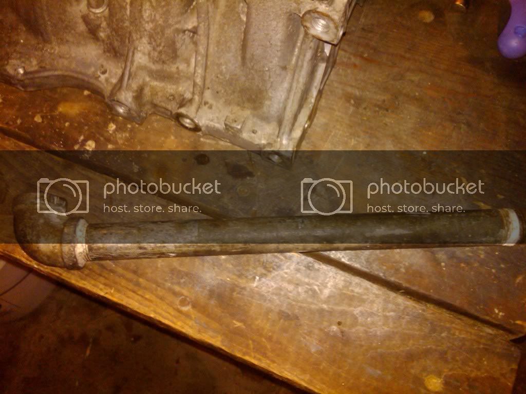

A disassemble tool must.

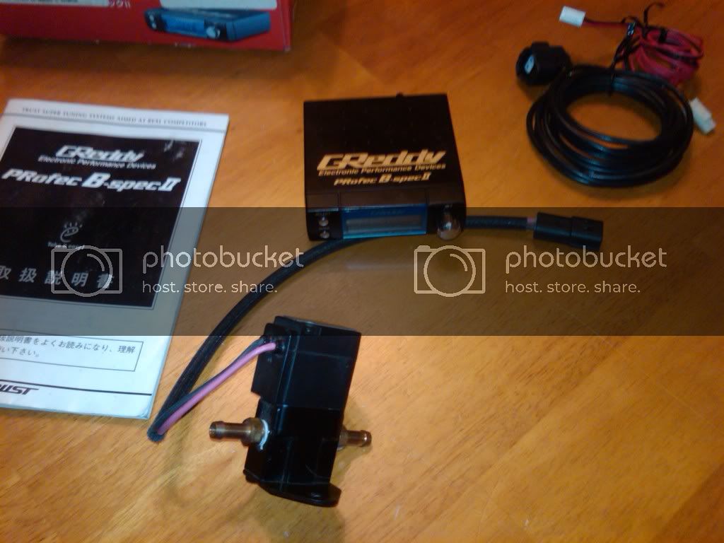

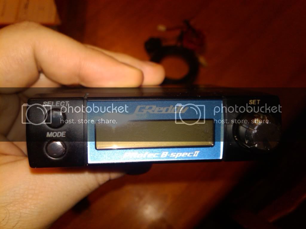

Greddy Profec Spec II boost controller. Things really neat, High/Low boost settings, boost warning, peak boost, last boost, ect..
Minty fresh.

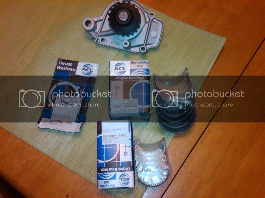

Some more goodies came a week ago...
ACL Main Bearings
ACL Rod Bearings
ACL Thrust Washers
Water Pump
