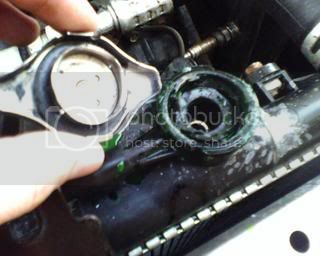

I am not sure if someone will get mad if I post this here, but you can move it if it is a problem. So after a year and a half of doin pizza delivery my Accord finally went up in smoke about 2 weeks ago(day before my birthday...LAME!!). So I parked her and was hoping that maybe...just maybe I had a bad radiator cap, or something of the sort. Well, I open the hood and this is what I see...

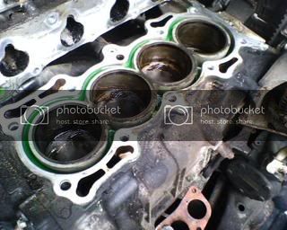

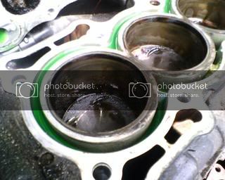

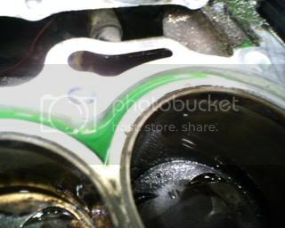

yes, that m*****f***** is completely melted away.. There is a hole in the resevoir where the pressure found a way out, which is where most of the smoke was coming from. Anways, I figure I "blew" my radiator. So I start tearing it out. At which point I see a stream...yes a stream of coolant running down from the head on the transmission side. So, as most of you know, that would be a headgasket. And of course it was, I pulled the head off today and here is what I found:
**Insert sad smiley here**
So, since I got a Cavalier as a temp car, I have a lot of time to work on it. efhondakid and I are going to do a trade for a H22a head and I am thinking of doing a h22/f22 set-up. Going to find someone to deck the block for me so the compression ratio is good enough for the h22/f22 set-up. Not too sure what the ecu deal is, but more reading and **Searching** is to come. Wish me luck!
Seriously. It never melted the fucking plastic for me......just looked like my car was crying cuz it's fucking brain like exploded lol. That's hardcore. Figure out why it melted it that bad?
well, before the shit went up in smoke, my temp gauge was about an inch over the red line...whoa. My oil temp was reaching almost 240 degrees, and I could smell coolant like I was snorting it. I dont know too much about how/why headgaskets go bad, but im sure those two things played a pretty good role in it.

usually the headgasket causes the overheating
not the other way around
headgaskets are wear items, they eventually go bad from use
do some more research on the H22/F22 combo
from what I have read its not a bolt and play frank motor
nope, it isnt. The compression ratio, if it was bolted right up, is 8.44:1 IIRC. And some of the oil drains dont line up. There is a tech post on HT, but its from '04. Anyone know of any other ones?
