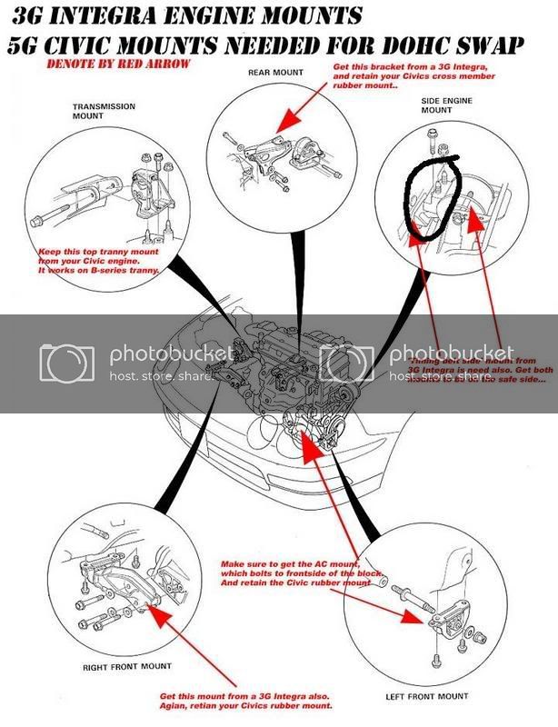

    32,376
    6,161
    I used HASports when I did mine, but the engine bay is the same as an EG so this guide would be accurate
