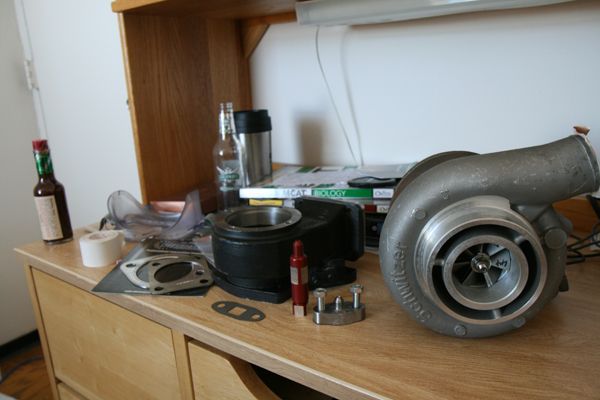

So, here is a complementary picture of parts--
Ignore the assorted crap on my desk.
