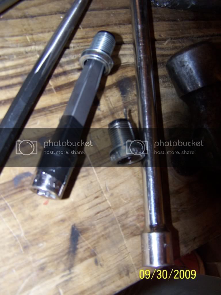

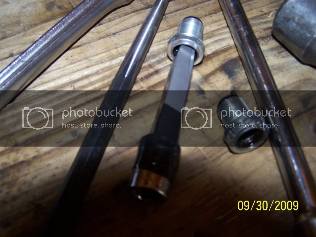

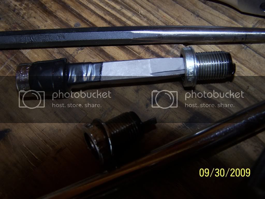

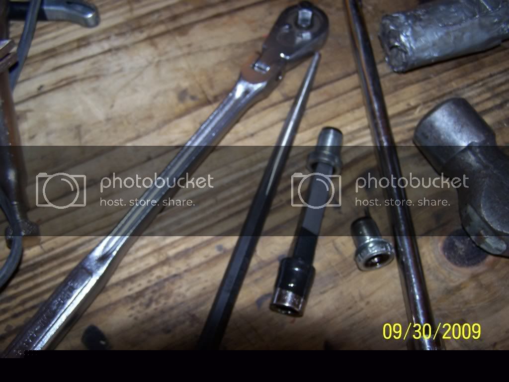

Dude Really??? broken spark plugs
FIXED IT!!!!!
1. Tools: 3/8 EZ-out, punch, Hammer, 3/8 drive long rachet, 8 in 3/8 drive extention, ½ socket, PB blaster, elec tape
2. No damage to the head or spark plug thread (in the head).
3. Questions? Post up!
That's Fantastic!! I like those type EZ-outs, but for some reason only have the crappy helical ones.
Ya know, Did it come apart like in the pic? (right under the 'hex') I'd write up a not so nice letter describing what you went through with "THIER" product.. You may get some free plugs..?
Ef-kid, I just did a rebuild on a XR80r last winter and I could see how it stripped the threads. It was most likely tightened too much at some point, tearing the threads back toward the plug. There isn't much meat there and only take about 15ftlb of torque. Just enough to seal it.
