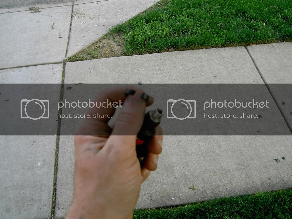

Well I was taking the car apart and found this. Its the seal that goes around the base of the fuel injector. Looks like I found my problem. At least its going to be an easy fix.
cool, glad you got it fixed again... :ph34r: .. keep us updated
Yeah an even better fix would be the rings off my stock injectors I just found. They are the exact same. I just realized I still had them right after I picked some up at advanced.
