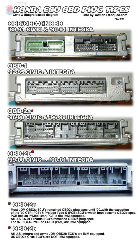

K katman Member May 20, 2004 #2 Originally posted by Fedz25@May 13 2004, 11:58 AM i need a pinout for this engine and ecu thx Click to expand... which PCT OBD2 version is the ecu? obd2a or obd2b ? and if you don't know how to tell, see this:
