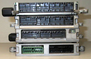

You can tell the obd by simply looking at it.
2B
2A
FROM top to bottom as pictured

I am aware the difference can be seen by looking at it but i'm trying to be 100% sure because i'm trying to buy one and the only way to be 100% sure would be by the part #'s. I cannot trust someone to get it right by explaining to them how it looks. The JDM vs. USDM GSR looks the same for OBD-2a but the part # verifies the difference without error. I need the JDM OBD-2a because I only have 1 O2 sensor and if I get the USDM I will have a problem.
that IS A USDM 5 spd, p72, you don't need a honda parts catalog to verify this, if you look at what sol posted, you could have figured it out. there are no questions about it, it is usdm.............
