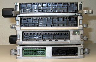

Top to bottom...
OBD IIb (left 3 plugs used)
OBD II ECU
OBD I ECU
OBD 0 (JDM PR3 and PWO)
Second from the bottom can plug into a OBD I car with no adapter.The others will need a conversion harness.
