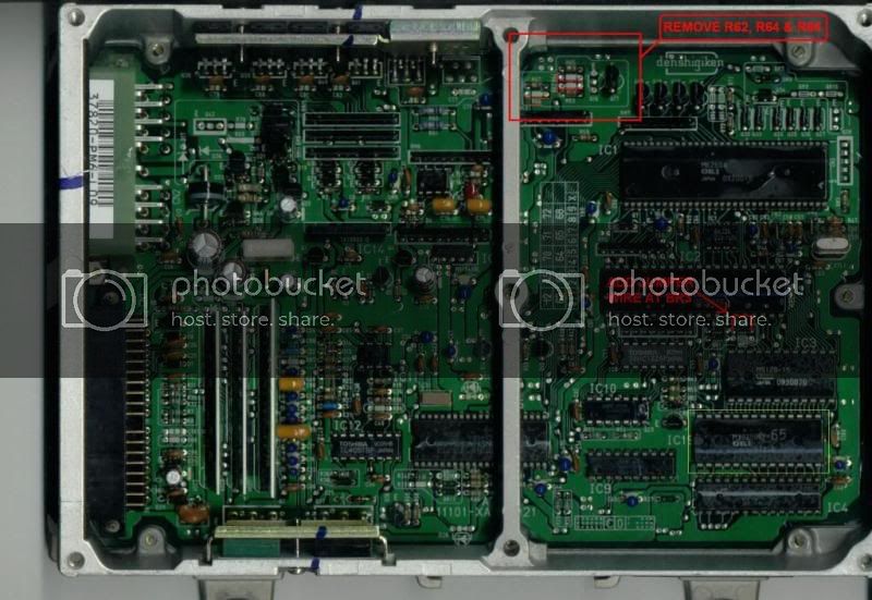

buy it and make it a 5 speed yourself... its easy to do...
So what ecu do i do this to? The one that's in the 91 d16a6 auto? (ECU name_p___?)
And at the top, do I desolder those 3 connections? And jumping that part makes it a manual?
And how does this help me/my situation? More power? Better ignition curve? fuel maps?
Sorry for the q's but i don't have the time for trial and mostly error..
E
that is the si ecu pm6 all hes showing u is how to make it a 5speed ecu. but u cannot use this computer untill you swap from dpfi to mpfi but yes all that should wake that poor old d15 right up
Wonderful! Thanks I'll be wrenchin this weekend to get that a6intake/harness and hopefully that pm6
