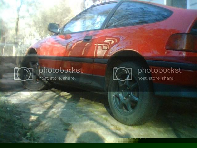

The Civic/CRXs can sit pretty high with stock shocks. If anything, just get slightly stiffer springs(best bet are lowering springs) and install those spring spacers. You could probably do it with stock springs to increase the preload but that might be harder.
This is how high my CRX sat after I took it off the jacks(so it'll lower when the car moves), but gives you a good idea about how high it'll be:
Also, DC/EG shocks assemblies are longer(like 1-2" IIRC, I just measured a couple of days ago but forgot), so those will probably help raise the car some. Not sure about the rears though.
K2e2vin- is that with front springs in the rear? Looks wicked :D Pretty much exactly what I'm after.
