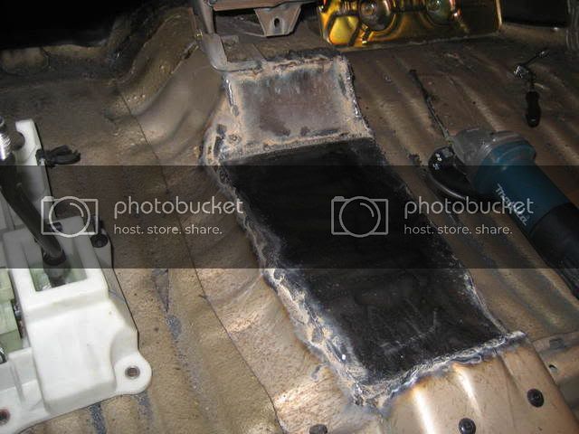

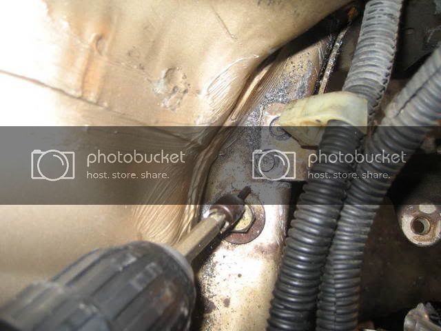

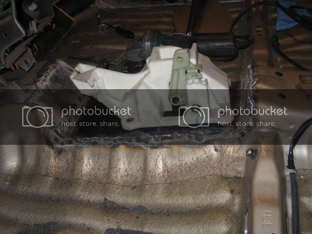

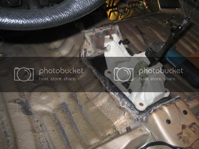

Shifter plate cut out. Karcepts has a kit for about 100.00 bucks but I made my own for alot less then that.
