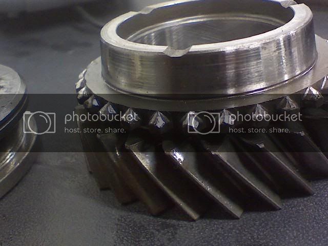

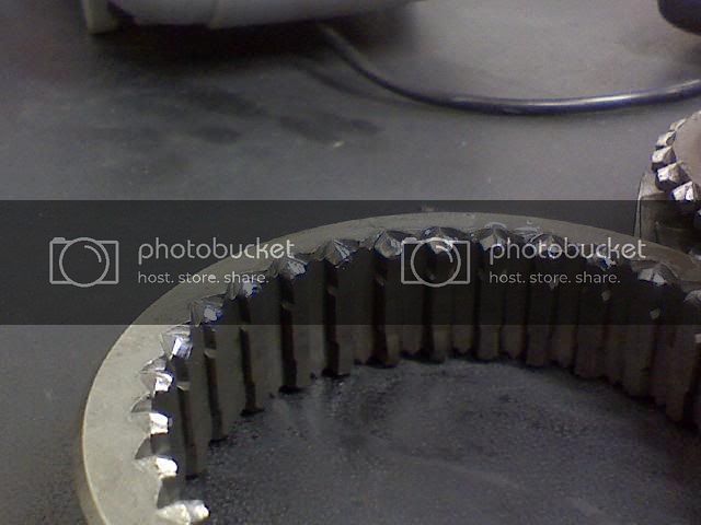

    It probaly needs more than just syncros when a syncro goes bad it causes gear clash with the slider. A gear has engagemanet teeth that should look like this /\ but when you grind the gears you are wearing the engagement teeth off and causing them to look like this \ or -- and then the slider has trouble going over it. If you dont know any thing about a transmisson you have know business opening it up and just throwing syncros at it. Its no diffrent than building a engine there are specific tolerances and things to check that should never be over looked.
    look at this pic this guy replaced the syncro but the teeth on the gear and slider are in bad shape and thes also should have been replaced
