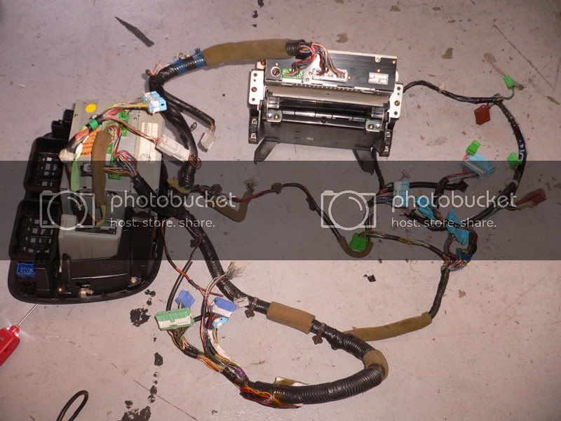

Hi, does anyone out there have any idea how to wire this up? Ican get the tape player to work but the screen won't light up. Any ideas?

you need all this:
and a 99-00 heater box and blower motor for the climate control to work (if you have a 96-98 ek)
the wiring is hard but not impossible
but, the nav will never work...the only software available for it is for Japan
-and the newer RL/TL nav dvd's won't work (cdrom vs dvd-rom)
you can get an FM modulator and it'll play regular DVDs though
