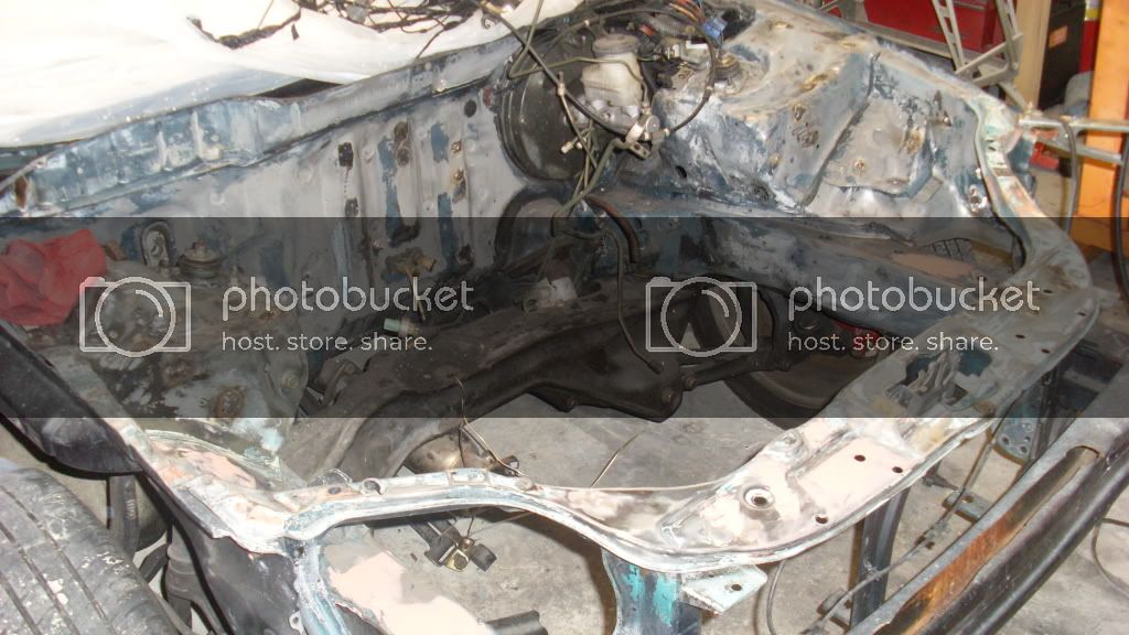

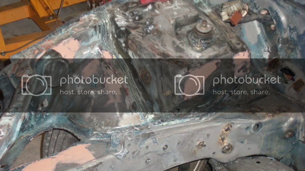

Been getting my dx ready for paint and a firewall shave, I used aircraft striper and i do regret it i should have just sanded it with 180.. If you look at the pics you can see where the striper did not work. Im doing the brake lines tomorrow and installing a inline fuel filter. I did the wire tuck in the past so thats been over with. Ill have some more updates tomorrow.

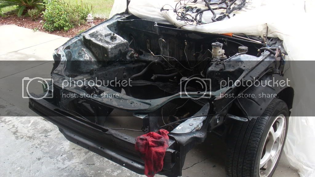

^^^^ no clear coat yet still hitting it with 2000 :)

Sand blaster FTW!! in areas like that where everything is contoured and you have all of those nooks and crannies, you can't beat a sand blaster. You'll aggravate yourself to death trying to hand sand it all, give up, and end up with really shitty paint work.

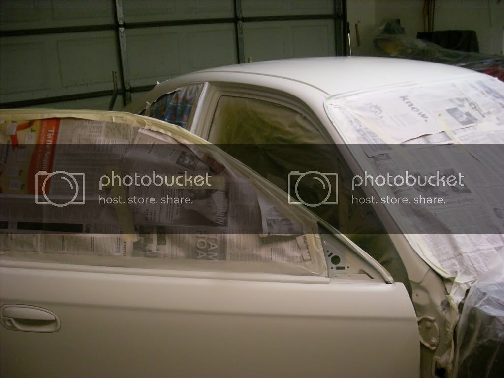

all champ white, i agree with the sand blaster worked good i hit all the stuff i was having a hard time with. More pics tomorrow.. Im gonna prime / paint the bay.
