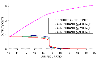

an o2 sensor goes off voltage, like most sensors.
here's 1 leading widebands vs a 3 narrow band o2's
other than at practically stoich, its reading is useless. the widebands translate a voltage into a number like 12:1 and make a gauge worthwhile.
Even under WOT, unless your car is running 14.7:1 at that given moment, its giving you a false reading. and if you car has to run at X ratio to get a right reading, well, then you already know what it is without a gauge.
