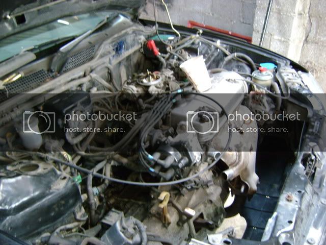

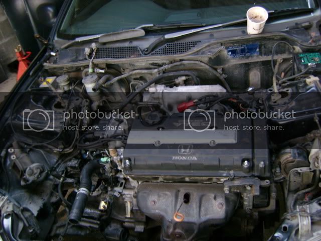

  18. johnOBD
    johnOBD New Member
    70
    Aug 24, 2010
    block conections on civic [​IMG]
