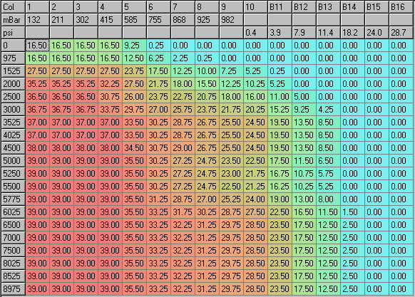

this is a sample ignition map:
nothing is tuned on the fly. however, there is a device called a "romulator" which allows you to mimic this.
