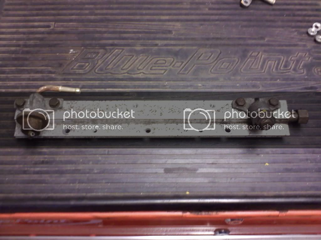

    Anyone with a cb7 doing a f22b1 swap out of a 94 and up accord will have problems with the fuel rail. I just got done modifying the fuel rail to work in the cb7. Heres some pictures of what you will have to do to make it work.
    This is what the fuel rail looked like origionally

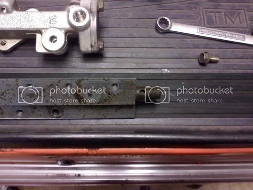

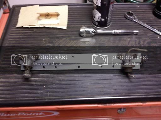

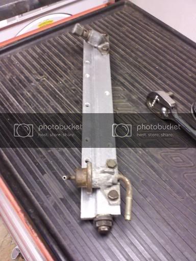

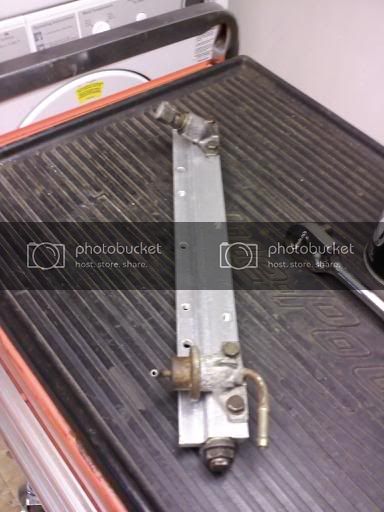

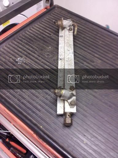

    I moved the fuel inlet to where the FPR was, I then moved the FPR to the right side of the fuel rail and I blocked off where the fuel inlet was on the end of the fuel rail. While everything was appart on it I cleaned up the rail itself and it looks alot better. Here are some pics of the finished product.
