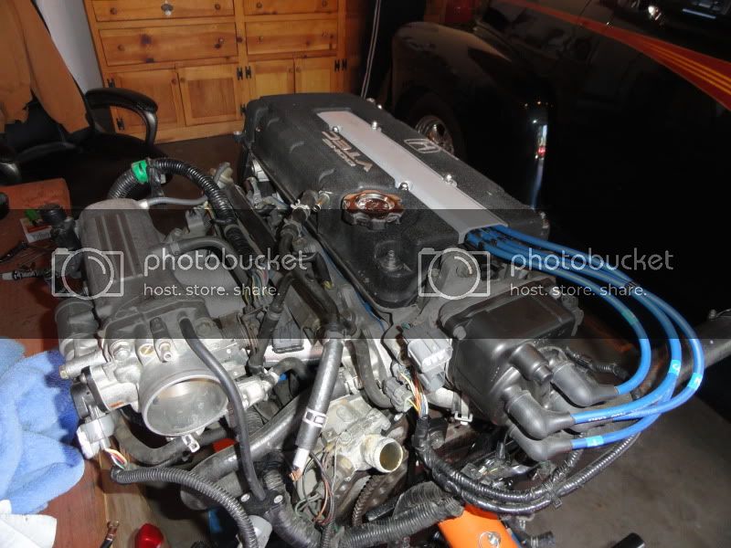

Let's see if this old pic of mine can shed some light.
Looks like this......On the distributor
3 4
1. 2
Number one cylinder is closest to the timing belt. Then it goes 2-3-4 towards the distributor
