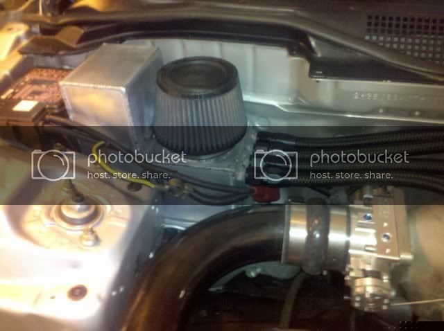

    Anderson IN
    this is my setup on my ek it works car makes 704hp at 24psi with a 67mm turbo data logs show crank case pressure at 1-3psi which is really good for a high boost motor.
